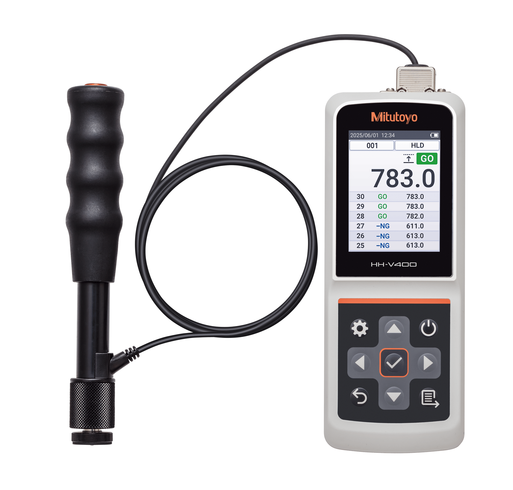

The Hardmatic HH‑V400 delivers lab-grade Leeb hardness testing to non-portable parts, from engine blocks and aircraft skins to gearing and structural steel. Set the material, press the button against the surface, and read the result.

Every impact is captured as Leeb hardness, then converted on-screen to HV, HB, HRC, HRB, Shore, or tensile strength — whichever scale your drawing calls out. Set GO/NG limits once and let the color-coded display do the QC judgment for you.

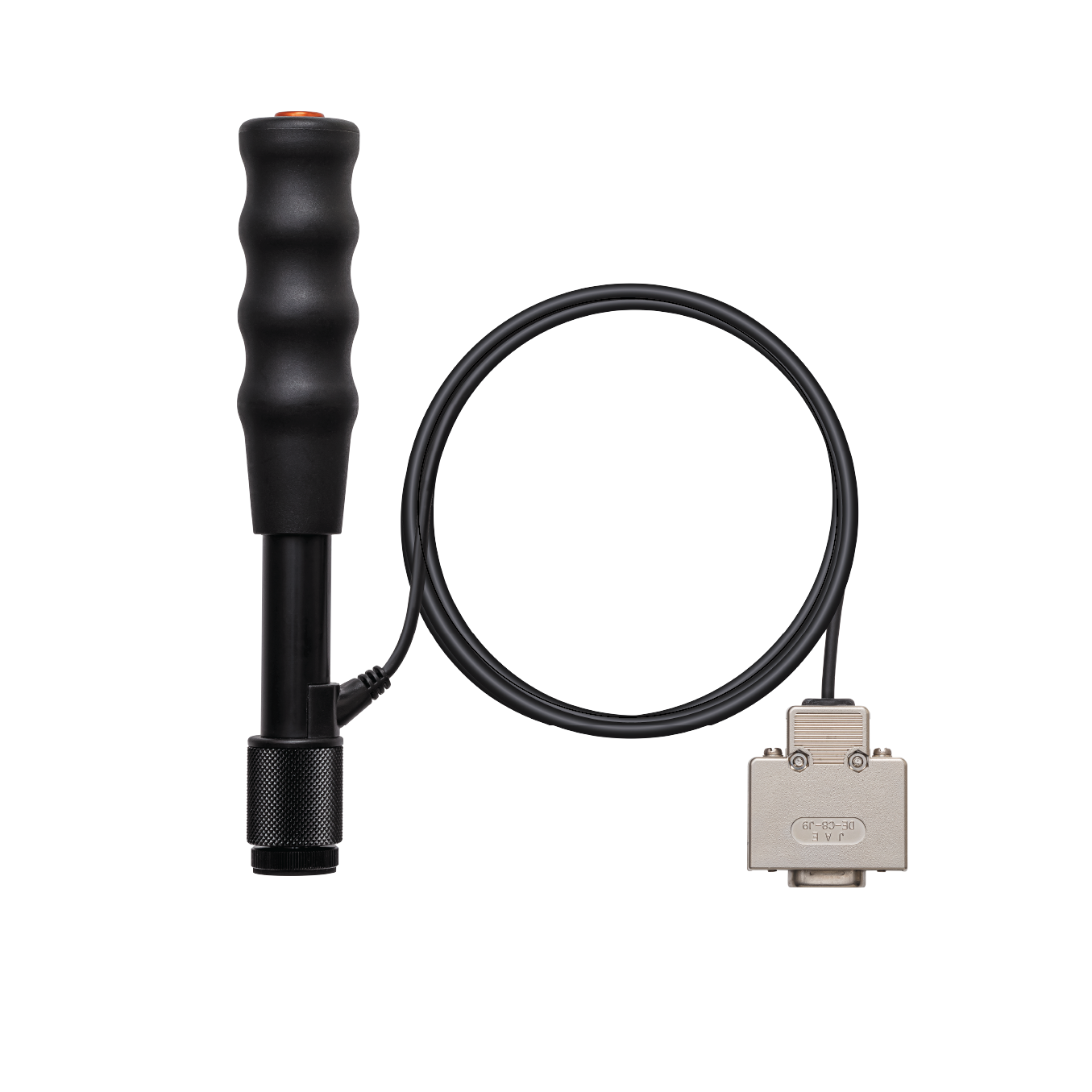

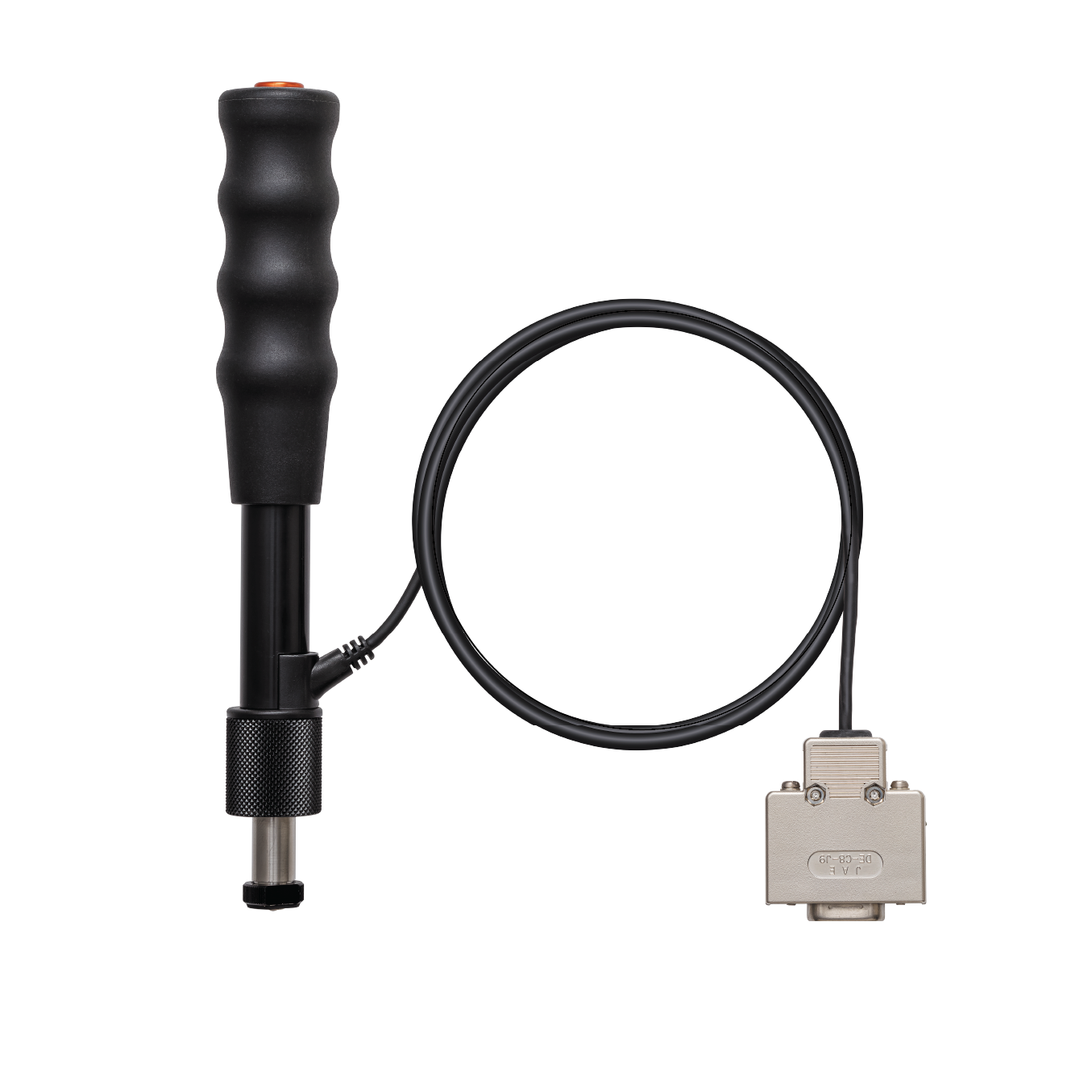

Detector D
General-purpose standard type. ø28 × 175 mm, carbide ball tip.

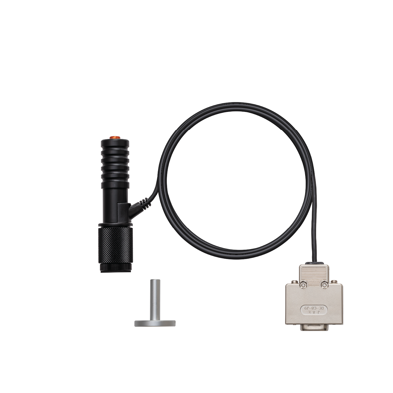

Detector DC
ø18 × 86 mm. Built for narrow spaces like the insides of pipes and tight bores.

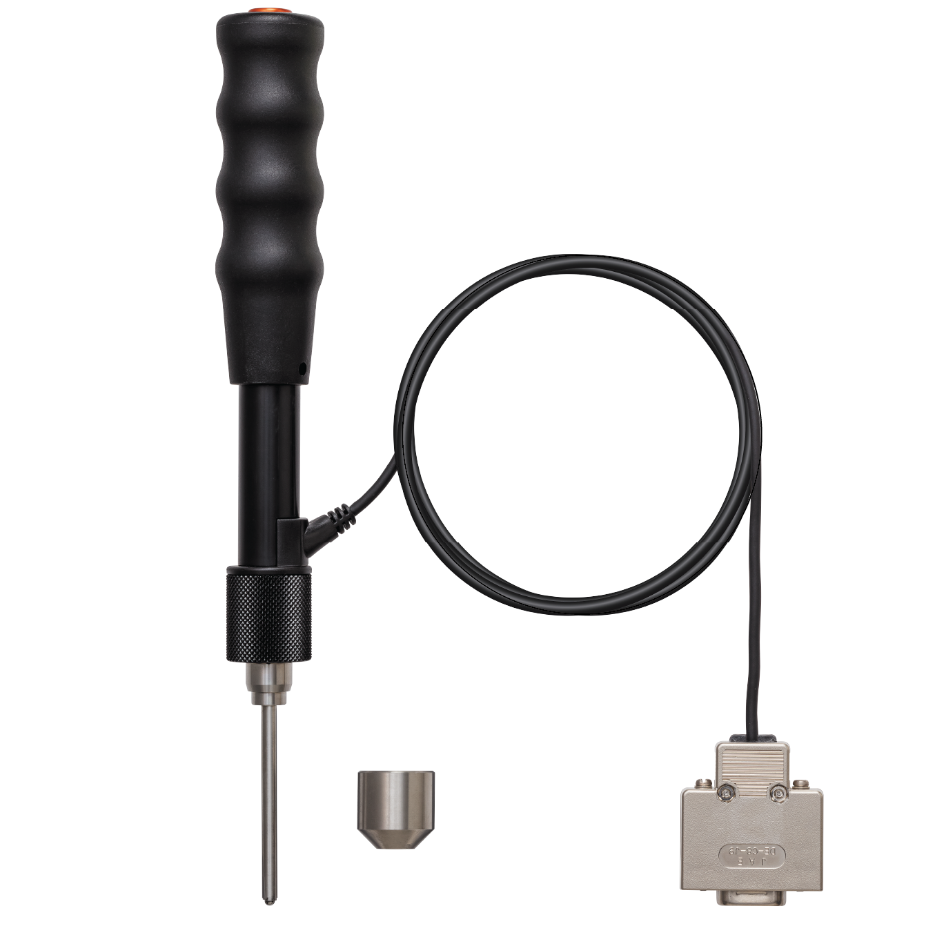

Detector DL
ø4 mm tip on a slender shaft — reaches between gear teeth and into deep grooves.

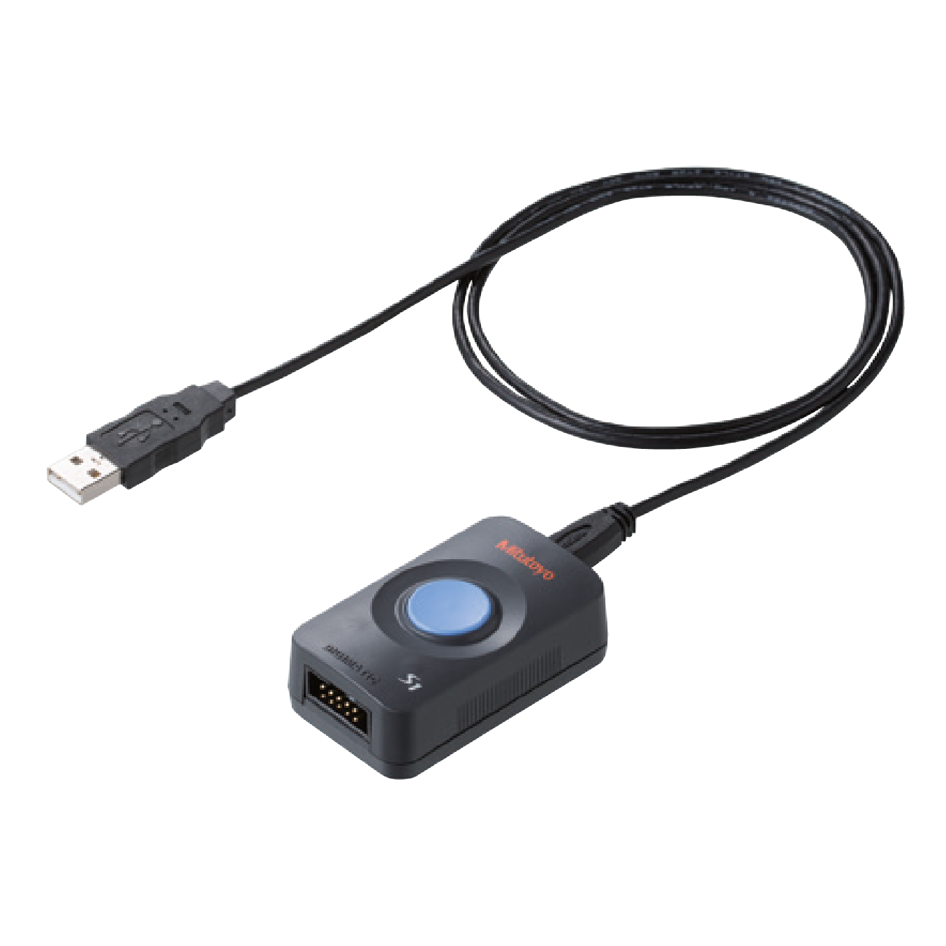

accessories-04
IT‑020U
USB input tool that feeds readings straight into Excel, Notepad, or any keyboard-wedge field.

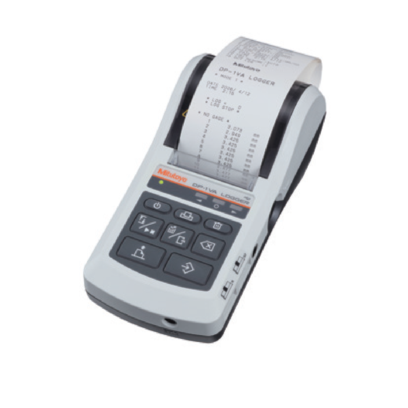

DP‑1VA Logger
Digimatic mini-processor for printing a physical record of every test.

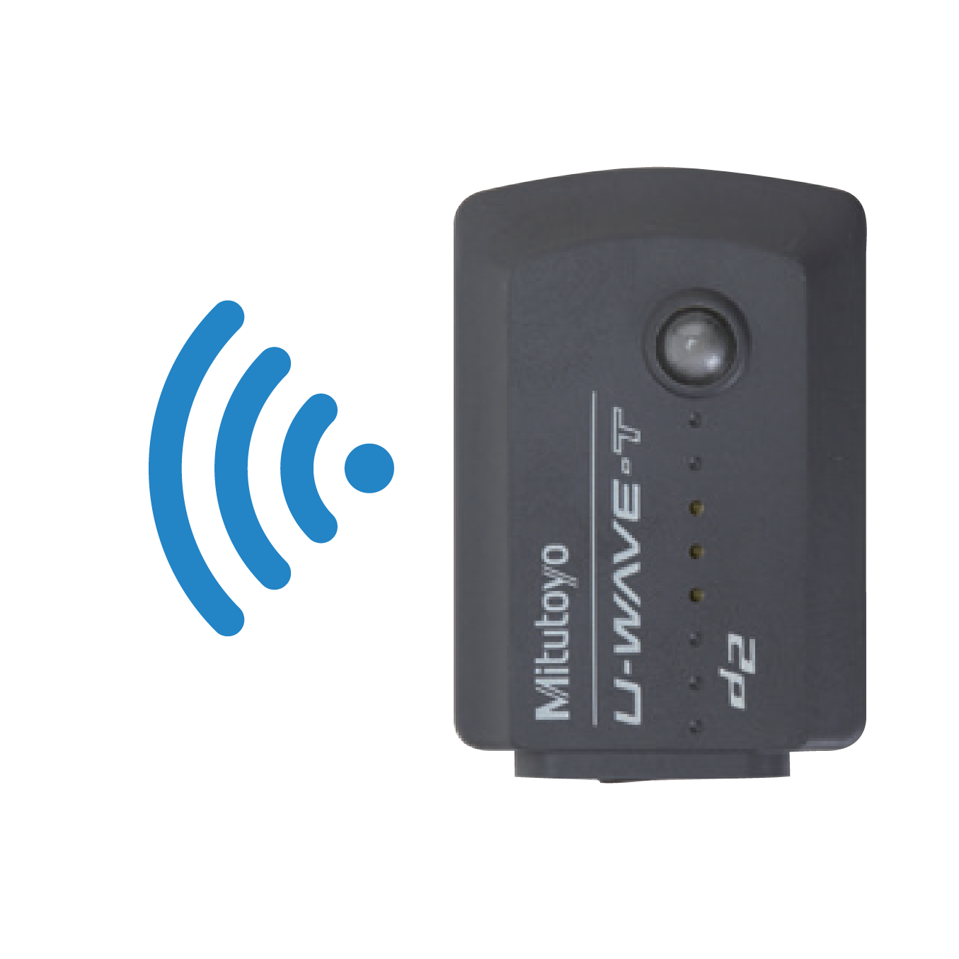

U‑WAVE‑T
Wireless data transmission unit (IP67 or buzzer type) that clips onto the display unit.
